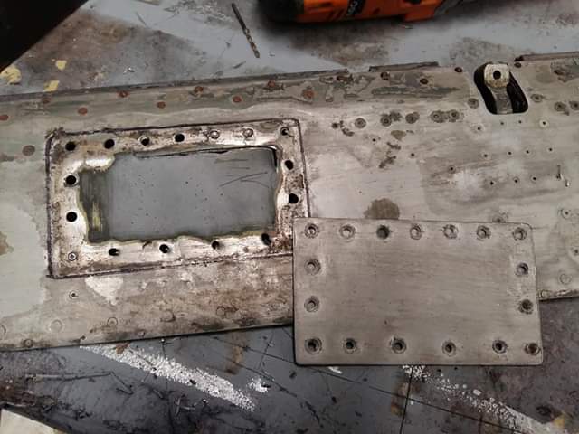

    Well, to say I was slightly grumpy (as were the team when I told them) would be a bit of an understatement. We don't do these things, just to have to re-do them because of some clown. Explanations and apology will be sought... Anyway, using the magic of my tablet and free hotel Wifi I should be able to bring you pictures... Firstly the removed scab patch, and the reason it was patched in the first place
    The new, flusher fitting patch
    After some tidying and fettling the whole upper surface of the tab was primed

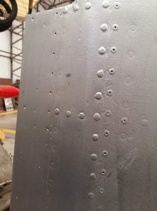

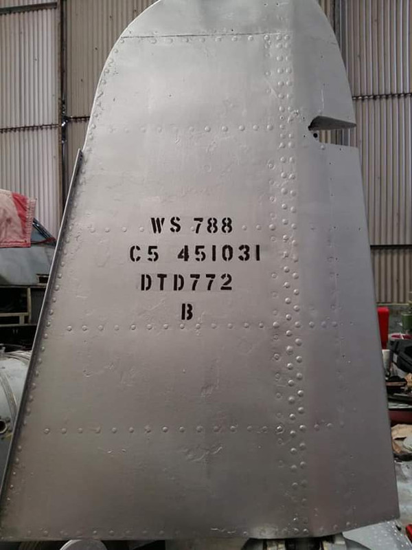

    It was around this point i discovered the anger-inducing damage to the rudder...

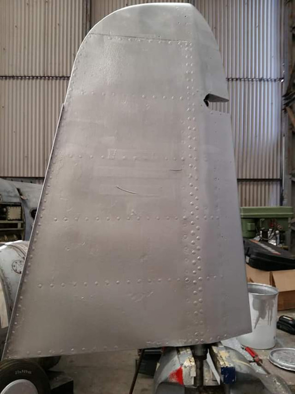

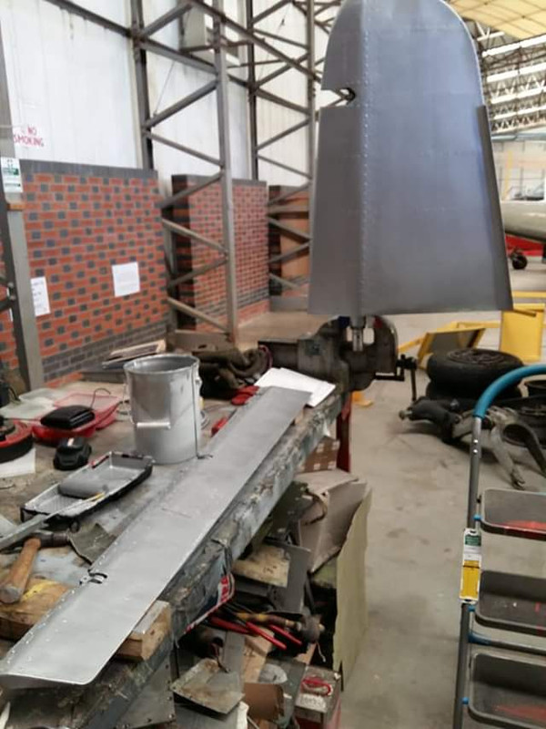

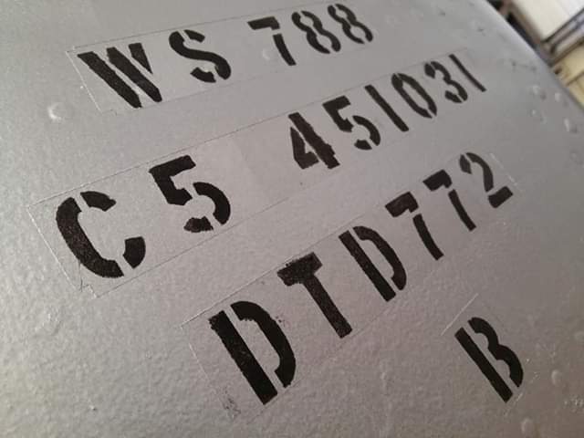

    So, the damage was rubbed back, the stencilling masked off as I really didn't want to have to ask Laura to spend another half day redoing it unless it was really necessary, then it was back out with the roller and silver paint.
    demasked, it didn't look bad...
    but close up there's a masking step that I hope will polish out once the paint has hardened properly

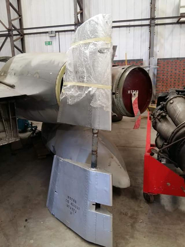

    It's come out OK, but it really shouldn't have happened. And rather than being on display, we've had to mummify it now for its own good.

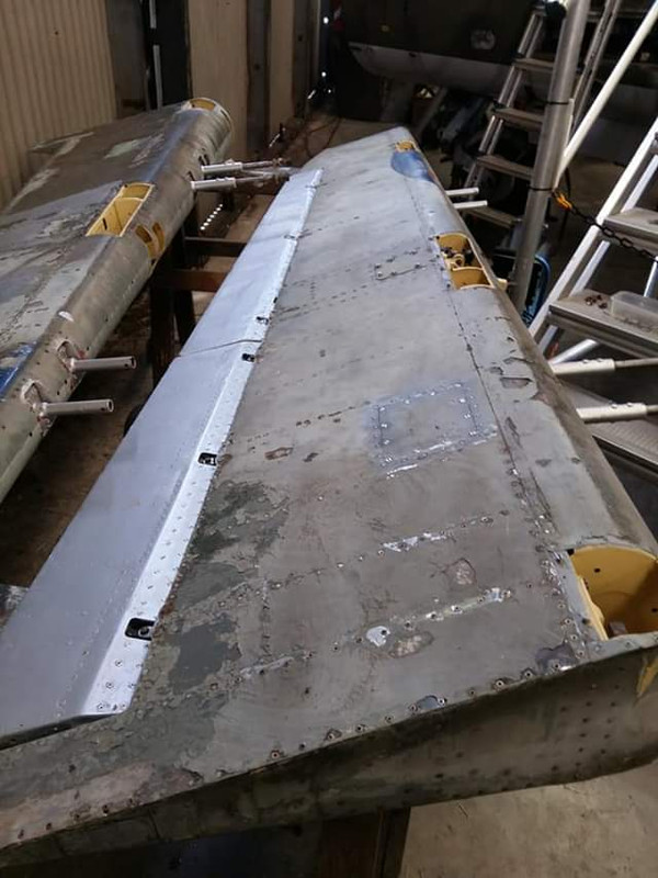

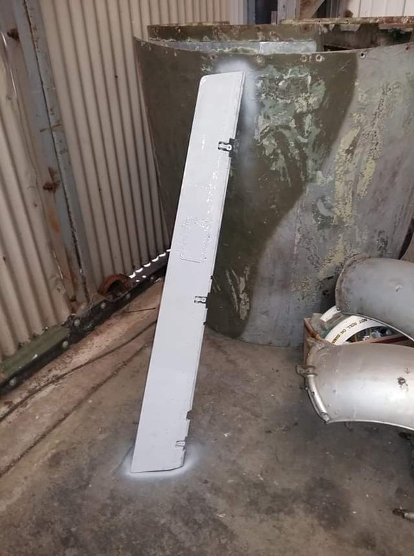

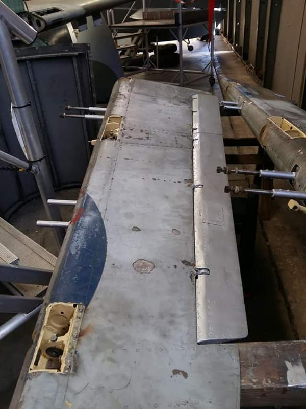

    Anyway the trim tab then went back on the aileron...
    And looks rather nice! Last job of the day for me, I refitted the door for the canopy opening switches, and started removing the panel as it needs some TLC and the isolator switch is snapped and needs replacing.

      OOOOHHHH!!!!! Picccies!!! Nice work there. I can see the need for the scab patch, what happened? someone have a go at the old girl with a can opener?
      Comment
      • Blue_2
        YAM Meteor spanner monkey
        • Feb 2010
        • 5018
        No idea Malcolm, she was like that before we started on her....

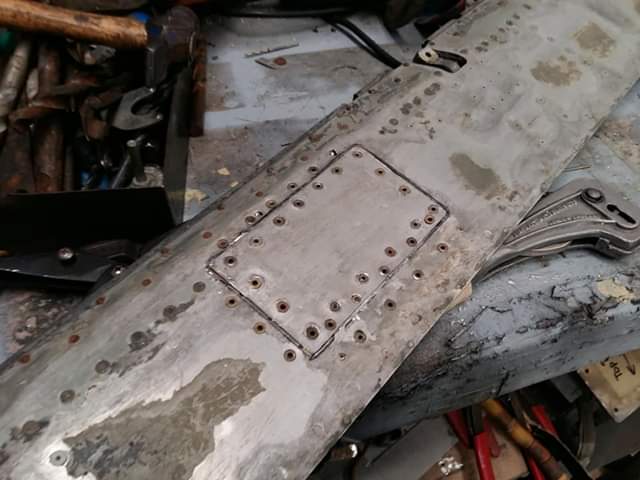

                  Fast forward to this weekend just gone, and we were finally let back in the hangar on Sunday to continue work on 788. Simon and myself were on site, and we soon found ourselves busy. I showed Simon how to get on with making the skins for the second aileron's access panels, which with a bit of help from Eloise he cracked on with

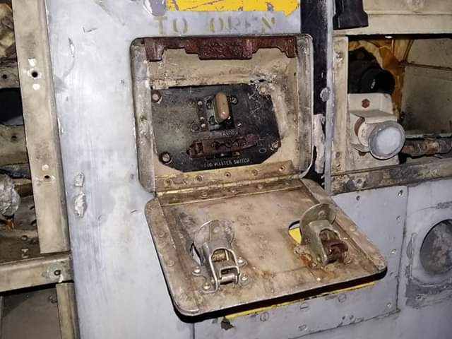

                  As my back is still far from great I refrained form anything strenuous, instead I finished stripping the canopy opening panel out of its bay, and dismantled it
                  I set to rubbing it back, straightening it (it's had a hard life, poor thing!) and rescribing the lettering, before it received a dust of primer then a coat of gloss black
                  The sprung canopy open/close switch proved to be serviceable, so was just lubricated, cleaned and refitted. The canopy master switch was not so fortunate however. But... we broke out a NOS spare we were fortunate enough to have
                  And soon the panel looked far happier!
                  It has come home with me for the lettering to be highlighted back in, probably tomorrow. Next job was rubbing out and repainting the panel's bay
                  In the afternoon I continued the fitting out of the aileron innards. This was aided by Simon bringing a local delicacy for York; Kitkat!
                  He carried on with his panel skin production line
                  Then I took one of his skins and showed him how we build it up with flanging, screw holes etc...then fitted the first panel he had made from scratch!
                  He was very proud, and justifiably so. I then made one of the inboard ones and fitted it...

                  Before we made a start tidying up. The port aileron is now by the bench awaiting the trestles coming available and the rest of its access panels finishing...
                  The starboard one is now positioned behind the wing, and just about ready to re-hang after a few finishing touches

                      Something that definitely is not NOS, and is very definitely original to the jet, is the canopy control panel. Remember it looked like this...?
                      Well one new master switch, some rubbing back, repainting and recaptioning later, and it looks like this...
                      All ready to go back on 788 tomorrow hopefully, as I am having a sneaky jet day if things don't change!
